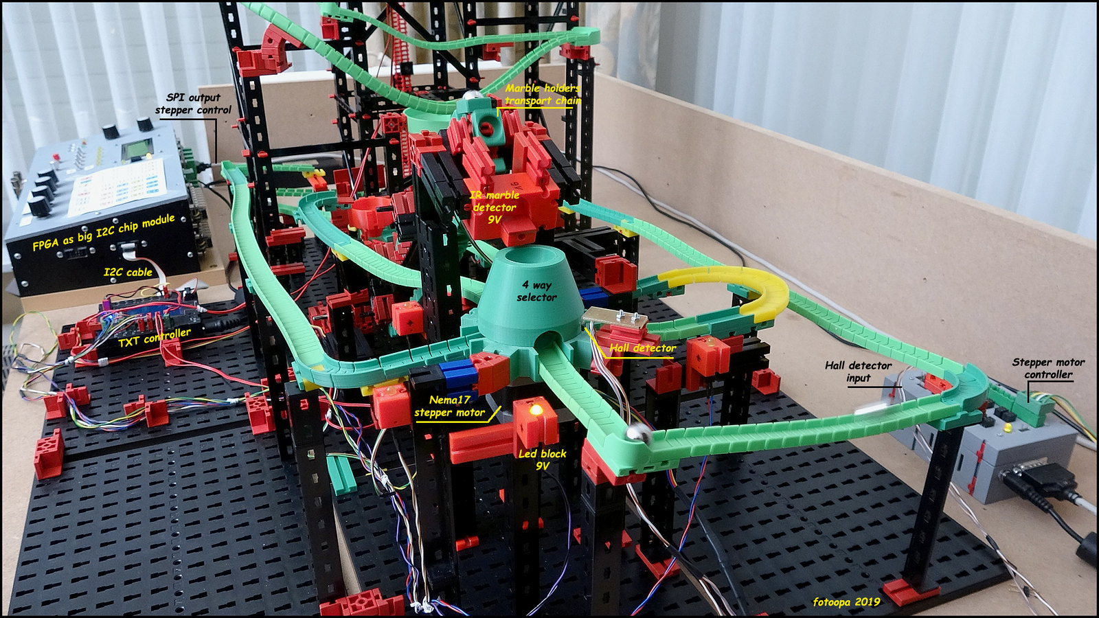

I follow Frans on both Flickr and YouTube.
He's also been building a massively overkill marble machine. He made his own controller for that, it's just wow.
The high speed in-flight insect capturing device he makes, which utilises two Nikon D7100 cameras is amazing as well, I think the one offered by Cognisys is based on his.
https://live.staticflickr.com/65535/489 ... b79f_h.jpg
This looks like a nuclear reactor :D :D
Bit off-topic, but I just love his work.
