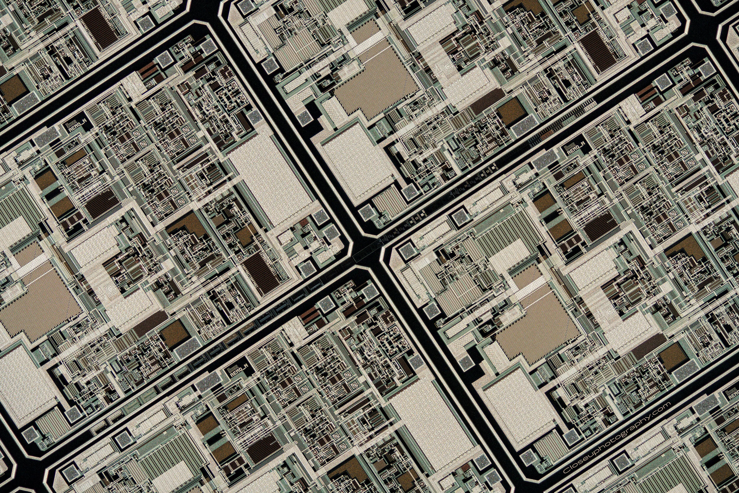

After all the testing I've done, I can highly recommended the AD120 for macro work on extension at 1x and in a stacked setup. I was able to shoot the Componon 2.8/35 wide open at 3.4x without any issues with CAs. See the 2500px image below.

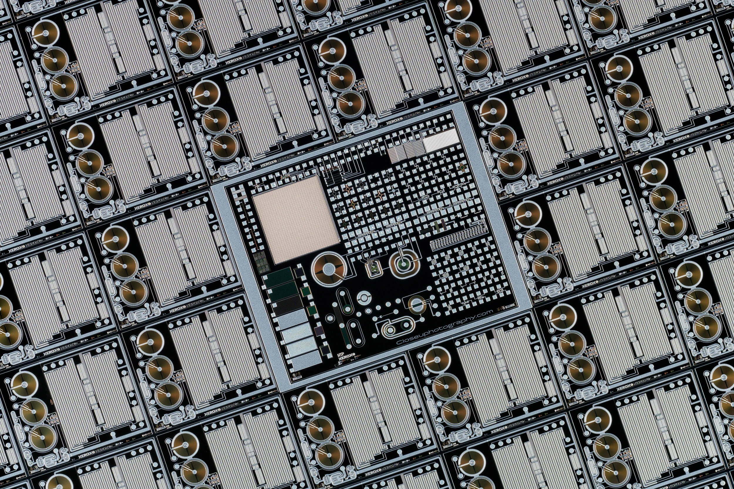

SHARPNESS TEST AT 1X
Front lens: Schneider APO Digitar 5.6/120 mounted normally and focused on extension
Nominal aperture: f5.6
Effective aperture: f/11.2
Camera: Sony α6300, model # ILCE-6300, also known as: A6300
Sensor size: APS-C. 23.5 × 15.6 mm. 28.21 mm diagonal. 3.92 micron sensor pitch
Vertical stand: Nikon MM-11 with a Nikon focus block
For this test a stack of images was made with 10 micron steps, and was repeated for each aperture. The sharpest frame was then chosen using Photoshop at 100% actual pixel view. Separate images were selected for center, and corner if needed. Each image was processed in PS CC with identical settings with all noise reduction and lens correction turned off, all settings were zeroed out (true zero) and the same settings were used for all of the images. All of the images shown here are single files.
SHARPNESS TEST AT 3.4X MAGNIFICATION
TEST SET-UP
Front lens: Schneider Componon 35mm f/2.8 lens reverse mounted
Nominal aperture: f2.8
Effective aperture at 3.4x: f/9.5!
Rear lens: Schneider APO Digitar 5.6/120 mounted normally and focused at infinity
Aperture: f5.6
For this test a stack of images was made with 2 micron steps, and was repeated for each aperture. The sharpest frame was then chosen using Photoshop at 100% actual pixel view. Separate images were selected for center, and corner if needed. Each image was processed in PS CC with identical settings with all noise reduction and lens correction turned off, all settings were zeroed out (true zero) and the same settings were used for all of the images. All of the images shown here are single files.
