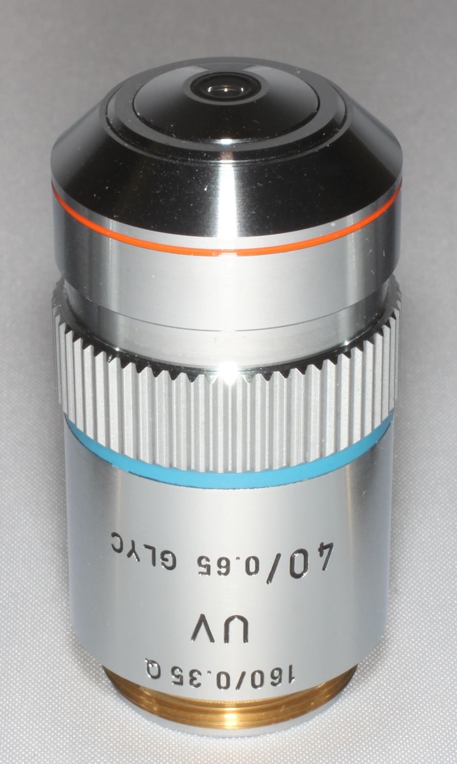

jmc wrote:Hi Ichty. do you have any documentation which mentioned the Leitz UV objectives. I have one (a 16x), but can't find anything about it anywhere. It'd be great to know a bit more about it.
Sorry I mis-remembered. They are not on the 1985 list, only the 0.17 mm cover versions http://www.science-info.net/docs/leitz/ ... s_1985.pdf That's why I didn't mention them in my reply https://www.photomacrography.net/forum/ ... hp?t=41685
They must have been produced for a very short time or for a very specific use - I can't find anything about them.

No problem Ichty. Any information about Leitz UV lenses is good, as I have nothing at the moment. From your document it looks like they did others as well then. It mentions Quarzobjektive for them, which suggests to me that these were quartz only rather than quartz and calcium fluoride. Do you know what tube length those ones in the document would have been for?
Leitz also made some infinity corrected quartz objectives (I've seen 20x and 32x for sale).

jmc wrote:Do you know what tube length those ones in the document would have been for?
I'm 99 % sure they would be for 160 mm.
Here is one more like yours: https://www.mikroskop-online.de/IMG_5601.JPG
Some older Leitz Q reflecting objectives used 0.18 mm quartz covers and 400 mm tube length (!) p. 66: http://www.science-info.net/docs/leitz/ ... ystems.pdf
