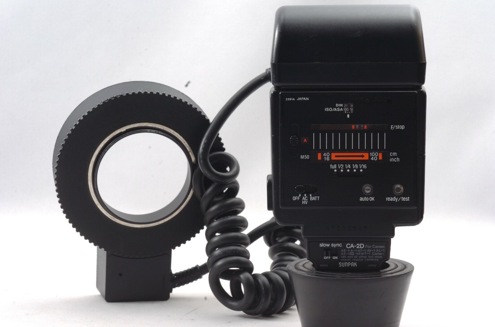

Gents,
Suggestions on xenon ring speedlites are highly appreciated, if you could. I need a cheap battery-powered full circle xenon ring flash, with less than 24v of trigger voltage, center trigger pin positive (like Canon, I heard Nikon ones have reversed polarity). To be used on an Olympus E-M1 mk1. Manual is good enough; no TTL or HSS is needed.
For example, I know Canon version of Sunpak DX-8R (eBay ID # 133068447173) may work, if its voltage is low. The bottom connector module that says "CA-2D for Canon" can be removed from the universal controller above.
https://i.ebayimg.com/images/g/wccAAOSw ... -l1600.jpg
The central controller, which is likely the same for all brand version, according to a forum member who owns an Olympus OM version, uses 6.7v (so I would expect the Canon version will use less than 24v for triggering): https://www.mu-43.com/threads/continuou ... -3.104477/
