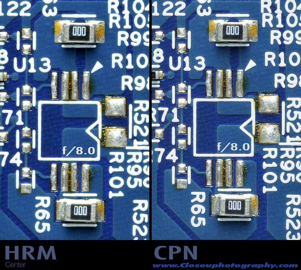

Anyway I finished shooting today and even processed some of the photos. I'll post some later tonight with some photos of how I got around the thread mount, I did not have time for a custom adapter.
The results are interesting. The lens lineup is below.
All tested at 0.2x
Qioptiq LINOS d.fine HR-M 2.8/80
Rodenstock APO-Rodagon-N 4/80
Rodenstock Rodagon-P 4/80 (plain Rodagon in an all Full Metal industrial mount)
Schneider Componon-S 4/80 Makro Iris
Sinar Sinaron Digital 4/80 (private label APO-Rodagon-N)
I'm on a break now and will post some 0.2x results later tonight when I get some time after dinner.
Any questions or suggestions are lenses to add, leave a comment below.

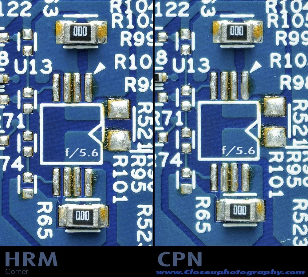

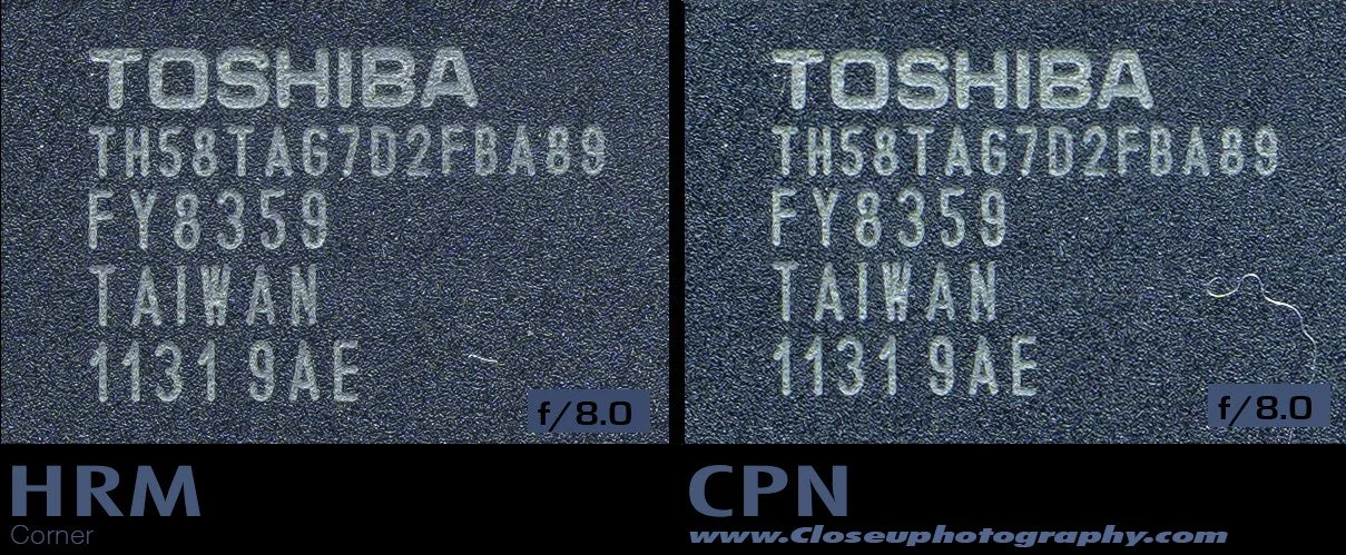

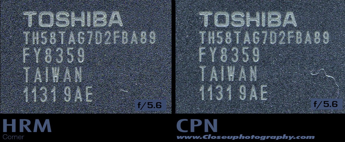

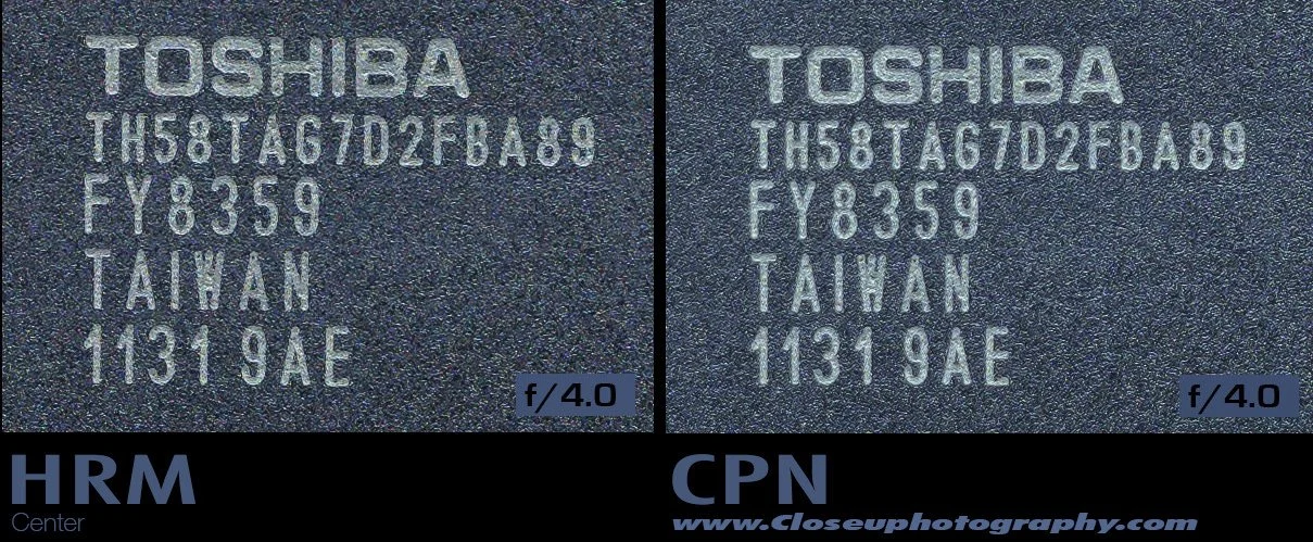

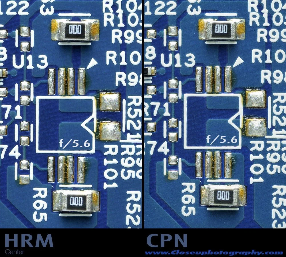

Still finishing the HR-M test page but in the meantime I can share some results. The other lenses I've tested will be included in a separate 80mm lens test page, with probably one or two more lenses added. I am going to include images from the Componon-S 4/80 to compare with the HR-M lens.
Focal length: 81mm
Maximum aperture: f/2.8
Aperture range: f/2.8 - f/16
Iris: 12 blade circular, no click-stops
Coverage: Ø 62mm image circle
Distortion: < 0.1% (design value)
Sensor pixel size: 3.5 - 5 μm
Manufacturers recommended magnification range: 0.2x ( 0.14…0.17x )
Wavelength range: 400nm - 750nm
Front accessory thread: M77 P= 0.75mm
Mounting thread: M52 P= 0.5mm
V-mount: No
Source: lens made in Germany
Design includes sensor cover glass: yes, 0.76mm D263
https://images.squarespace-cdn.com/cont ... rmat=2500w
Rodagon 50mm for scale.

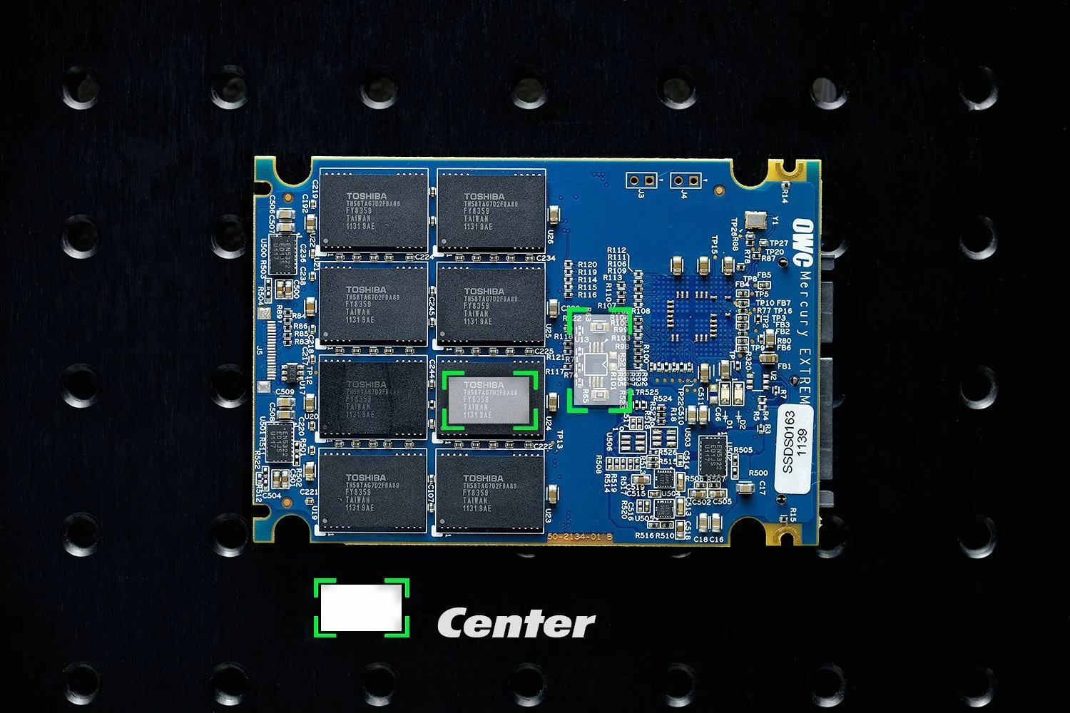

0.2x Test: HR-M vs Componon-S
0.2x Test setup
Camera: Sony A7R IV, Sony Alpha ILCE-A7R IV (A7R4)
Sensor size: Full Frame. 35.7mm x 23.8mm. 42.9 mm diagonal. 3.76 micron sensor pitch
A stack of images was made using a Nikon MM-11 stand with a Nikon focus block. The sharpest image was chosen at Photoshop at 100% view. The single RAW file was processed in PS CC with all noise reduction and lens correction turned off, all settings were zeroed out (true zero) and the same settings were used for all of the images. All test image crops are taken from single image. All test image crops are taken from single images that have been processed identically.

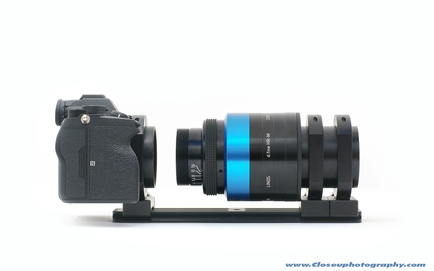

Mounting the lens
The HR-M uses M52 x 0.5 mounting threads. M52 and SM2 threads bind and Qioptiq did not send an mounting adapter for some reason, so I had mount the lens using the M77 x 0.75 front threads for the test.

0.2x Test Sample Images
Note: below each image is a link for a slightly larger image. For best results click the link and download the image. Web browsers soften images slightly for a smoothing effect.
https://images.squarespace-cdn.com/cont ... rmat=1500w

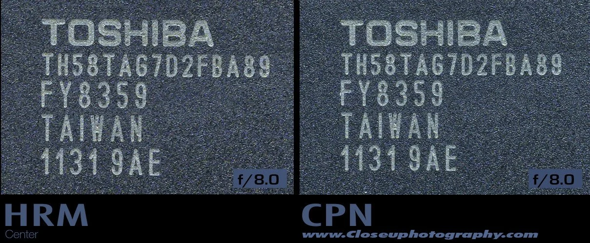

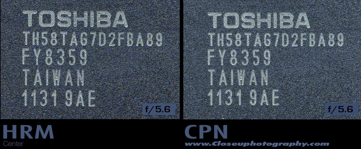

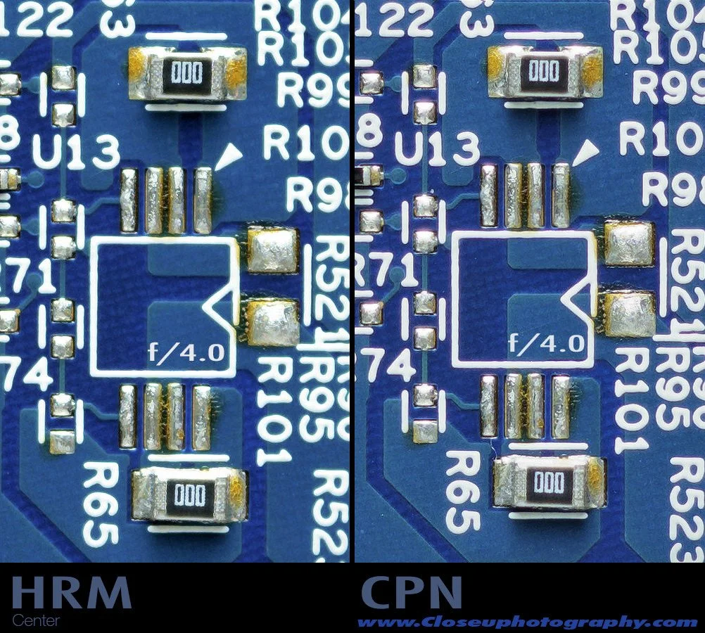

Chip center crops

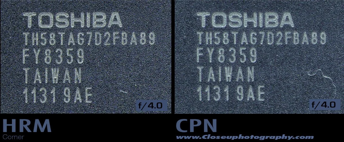

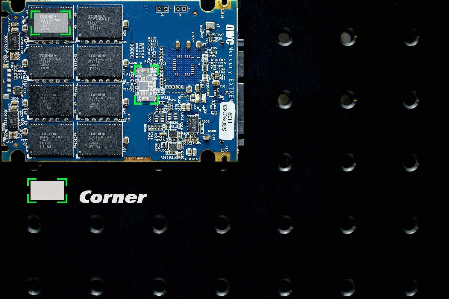

Chip corner crops
Will update this post later when the main test page on my site is up and finished.
Questions and comments welcome.

Re: Qioptiq LINOS d.fine HR-M 2.8/80 0.2x Lens Test Results
Thanks a lot for your testing - really interesting to see! It seems like the difference in the center is visible, but not that big, while it's a completely different story in the corners, where the difference is enormous.
I'm looking forward to your review and some sample shots outside, if you got a chance to do some regular shooting, particularly wide open. It's a pity those things are so extremely expensive - would be wonderful to try a high-end lens with those properties to see the difference compared to my lower-level 75/80 mm f/2.8 enlarging lenses...

Hi Simplejoy
It was really hard to find something close to that size with enough detail.I shot 5+ different targets over the course of a few days and the details were too large (tiny printed text), too fine (wafer details), or too reflective (wafer), or would like great on my computer but really lackluster online (paper currency). The SSD chips were all I could find that looked decent online. Eventually I'm sure I can find proper target with the right sized structures but I'm sure I won't have the lens then
One more note, I don't want to move to a USAF 1951 group type target either. I'd like to keep using more interesting than that but I have to say that might work pretty well in this case.
I'm used to drop off in the corners, it's pretty typical.
I do plan to shoot the lens, at infinity (for a stacked setup) and in reverse but I don't see the performance there to anything special. It would be ideal to shoot something outdoors at f/2.8....I'll try my best. Did you see how I had to mount the lens from the front threads?
I think 80 to 105mm EL lenses look great for most subjects. My most used lens over the last couple of years? A 90mm APO-Componon HM (the linescan version), I think I mentioned that before?

RobertOToole wrote: ↑Tue Dec 13, 2022 10:56 pmHi Simplejoy
Yes, true with the center. I think the main issue is the target area vs detail. I think the HR-M would do much better with a target with smaller and finer structures on it.
As you're aware I don't know the first thing about shooting test targets, but I can absolutely appreciate how hard it is, to find something appropriate for such a comparison.
Yeah, I've seen the mounting, but I'm not familiar with the properties of the parts you had to use... is it pretty heavy and cumbersome to shoot outside? I'm somewhat used to being forced to mount lenses via the front thread (inside my bellows) but I'm usually able to keep it down to a reasonable weight for regular shooting. Given how big this lens seems, this would definitively be a challenge to mount for me. What were they thinking when they decided to use a 52x0.5mm thread?RobertOToole wrote: ↑Tue Dec 13, 2022 10:56 pm
Too bad you don't live closer!
Best,
Robert
Do you have any interesting enlarging/industrial lenses in that focal length range which are fast enough to compare them at f/2.8? Maybe the Magnogon 75 mm (https://www.closeuphotography.com/roden ... on-75mm-f4)? I'm sure the d.fine will blow that one out of the water though wide open...
Interesting that you used the Apo-Componon HM 90 mm the most, but I'm sure it's an excellent and versatile lens and given how much I appreciate the same aspects about the Apo-Componon 60 mm Makro-Iris I totally get it.

Hi Robert,RobertOToole wrote: ↑Tue Dec 13, 2022 10:56 pmI think 80 to 105mm EL lenses look great for most subjects. My most used lens over the last couple of years? A 90mm APO-Componon HM (the linescan version), I think I mentioned that before?
your lens test are very welcome and as usual a big pleasure for me to read through :-)
But at 0.2 magnification how would let's say a Sigma 105/2.8 macro lens compete (with AF and automatic aperture) compared to those hard to adopt and all manual lenses at a considerable higher price. Is this worth the effort for a FF camera? Especially when we can use the lens at f5.6 for such magnification. How much better are colors or sharpness?
I think it's not so much about color and sharpness, but rather distortion, quality control and corner sharpness that makes the lens expensive (and the manufacturing process is probably lower volume too)lothman wrote: ↑Wed Dec 14, 2022 7:15 amBut at 0.2 magnification how would let's say a Sigma 105/2.8 macro lens compete (with AF and automatic aperture) compared to those hard to adopt and all manual lenses at a considerable higher price. Is this worth the effort for a FF camera? Especially when we can use the lens at f5.6 for such magnification. How much better are colors or sharpness?
chris
I think the test targets are very appropriate, to me it seems rather that the lens approach the resolution of the sensor pixel size.
a very interesting detail is that corner sharpness of the Schneider Componon-S 4/80 Makro Iris is prety poor wide open, but sharpens up a lot by F8 and seems to have a built-in unsharp mask filter ie. the resolution is still lower, but the apparent sharpness gets a boost and seems higher then the HRM. very strange.

Yes, I noticed that. All of the Componons makro iris lenses are designed to be used 2 stops down so the results fit. The newer lenses for digital like the Sinaron I tested are best at f/5.6 looks like. I'll post the 80mm EL lenses test results as soon as I finish with this one, its interesting to see the different lenses sharpness peak at different apertures.chris_ma wrote: ↑Wed Dec 14, 2022 8:16 amI think the test targets are very appropriate, to me it seems rather that the lens approach the resolution of the sensor pixel size.
An interesting note on magnification. Schneider quotes different design optimum magnification depending on who was writing the marketing PDF. For the 4/80 makro iris, it was 0.5x (doubt it) other times 0.3x (doubt that also) but the MTF graphs in the PDF are; 0.04, 0.1 and 0.3x (with worse corners). But the EL 4/80 PDF says 0.16x is the designed magnification. Then I found an internal engineering copy of the 4/80 makro iris lens with an optimum magnification for 0.17x. So optical engineers say 0.17x is optimum, marketing department says 0.5x is optimum.
Best,
Robert

My first thought was that it was an internal thread that would be used for a larger v-mount. That makes the most sense since using a lens with an azimuth mark with a stationary non-rotating mount means the lens f-stop indicator ring will always be under the lens, at least it was on this copy
This lens makes me appreciate the connivence of a V-mount a little more.

Test Update
A Thorlabs USAF 1951 Resolution (R3L3S1P) target arrived today and I was able to make some tests. The 3 x 3 inch target goes from -2 down to 7. Looking at the results I decided to re-shoot all the lenses over again.
There goes my Sunday but it should be interesting
At some point I will make a tutorial on using the USAF 1951 Resolution target since I couldn't find any online, which I thought is a bit strange.
Best,
Robert

- rjlittlefield
- Site Admin
- Posts: 23625
Perhaps you're already well experienced with using these targets, but if not, then be aware they don't tell you a lot of what you'd like to know.
For illustration, see the lens comparisons at https://www.photomacrography.net/forum/ ... 82#p136282 versus real subject comparisons of the same objectives at https://www.photomacrography.net/forum/ ... 75#p129875 .
