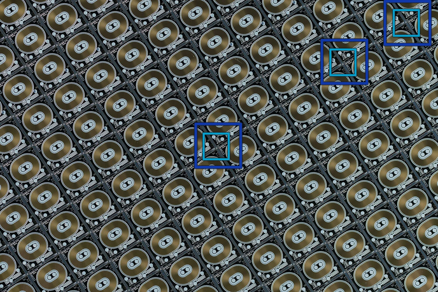

A stack of images was made at each magnification on a Nikon MM-11 with a Nikon focus block. The sharpest image was chosen at Photoshop at 100% view. The single RAW file was processed in PS CC with all noise reduction and lens correction turned off, all settings were zeroed out (true zero) and the same settings were used for all of the images. All test image crops are taken from single images. All test image crops are taken from single images that have been processed identically, with similar sharpening, unless noted.

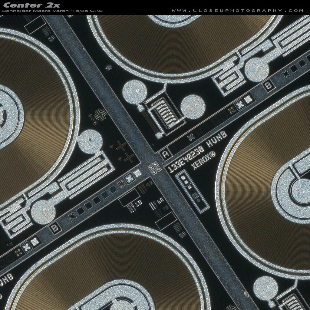

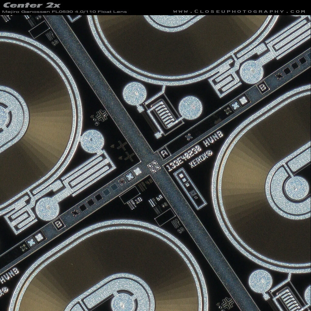

100% CENTER CROP AT 2X
At 2x the MP-E was tested at f/4 for best results, the Mejiro was set at f/4.5, and the other two where used wide open.

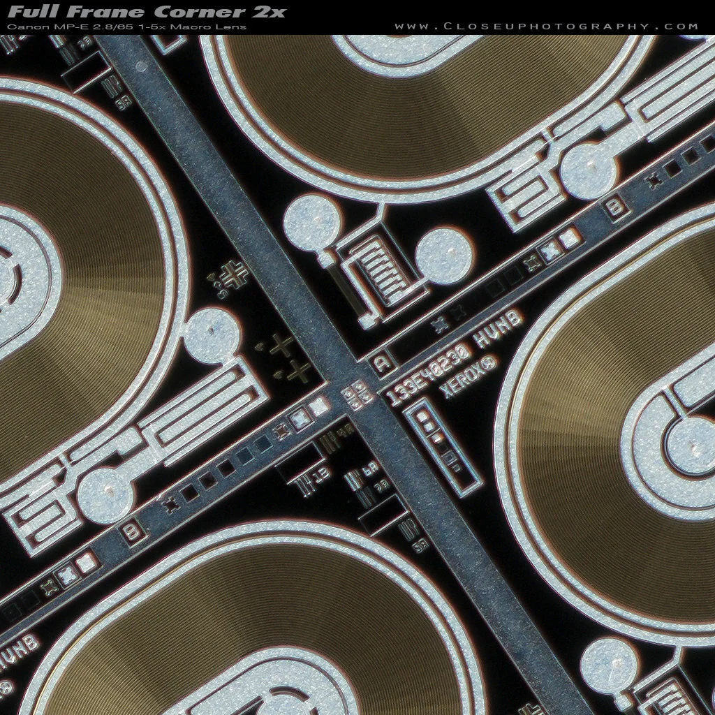

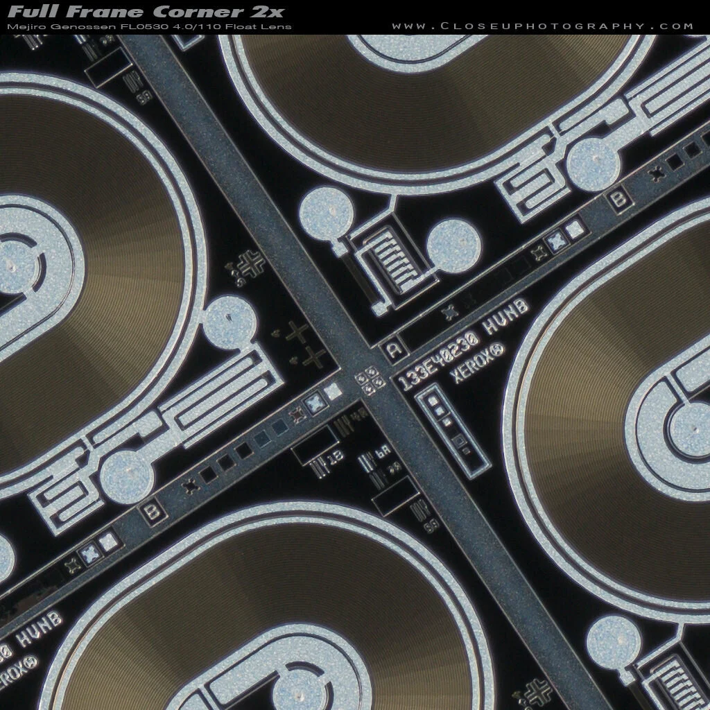

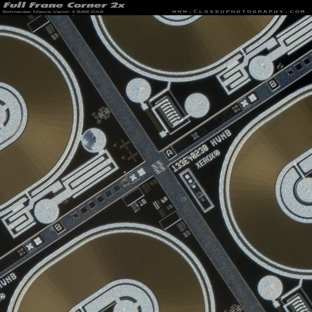

100% FULL FRAME CORNER CROP AT 2X
https://images.squarespace-cdn.com/cont ... rmat=1500w https://images.squarespace-cdn.com/cont ... rmat=1500w https://images.squarespace-cdn.com/cont ... rmat=1500w https://images.squarespace-cdn.com/cont ... rmat=1500w

The Mejiro is feels substantial in your hand like solid chuck of metal. CA control is excellent. Sharpness is good. Range is great. Huge image circle. Very consistent across the Sony A7R4 sensor.

Great sharpness and small compact size. Lens is sensitive to veiling glare even 100% flocked and used with a long shroud! CAs are well controlled everywhere.

Probably the sharpest lens here but also showed red fringing in the center/corners and stopped down 1 stop. Aperture setting is always a balance of red CAs and sharpness. Very good at the low end but IQ drops towards 5x. Best at 1x. Image circle was showing IQ fall off in the far corners on the Sony A7R4.
