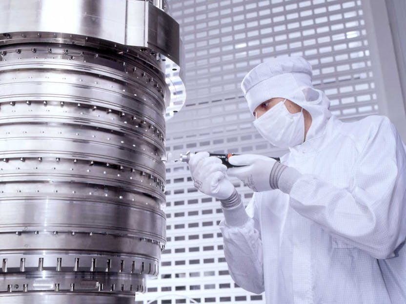

the zeiss website also has a cool looking one:
I suspect that weights and costs a bit more
