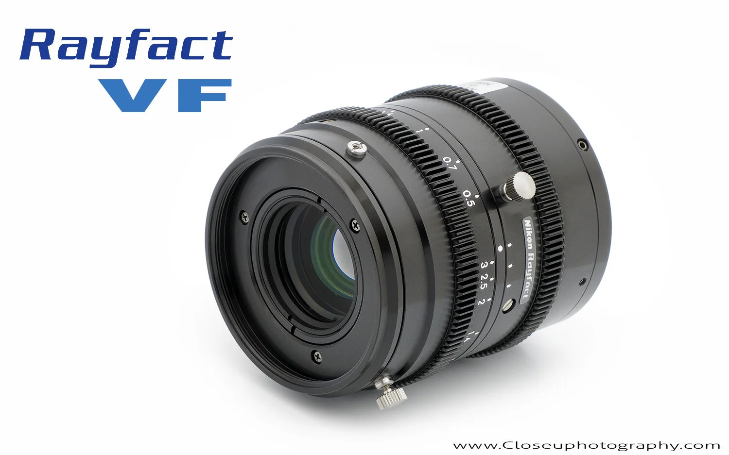

Rayfact VF Lens Test
Rayfact Part Number: L-OVM30093MN
Full test report: https://www.closeuphotography.com/nikon ... -lens-test

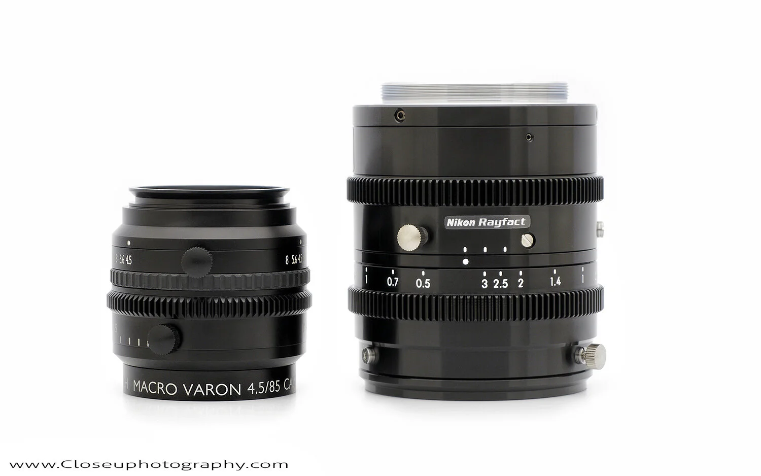

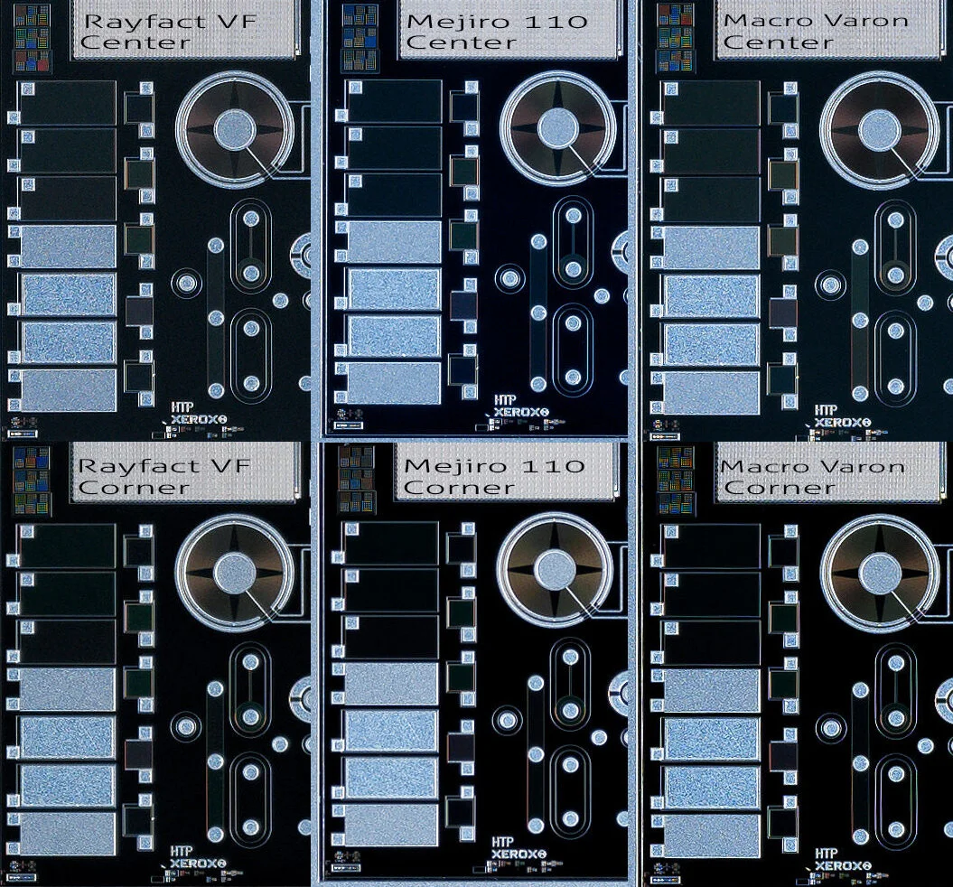

Lenses compared at 0.5x:
Mejiro Etendue M-Zoom line scan lens at f/4
Rayfact VF line scan lens at f/4
Schneider Macro Varon CAS line scan lens at f/4.5
0.5x 100% crops, click on each image below to open a larger size file. See the full report on my site for individual crop images.
Each crop section is just a small section of the wafer and the details resolved by all three lenses was amazing. The biggest difference other than sharpness, where the Mejiro seems to be a little behind the MV and VF lenses, is the contrast. The MV seems to be behind the VF and Mejiro. All 3 lenses were fully flocked and tested with a lens hood.

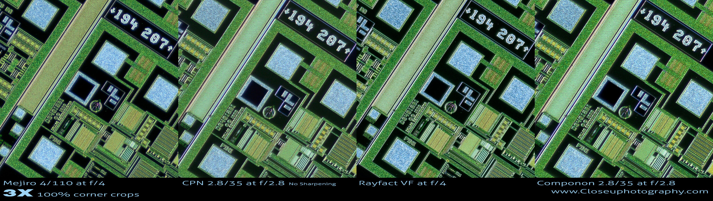

Lenses compared at 3x:
Mejiro M-Zoom line scan lens at f/4 (effective aperture: f/16)
Rayfact VF line scan lens at f/4 (effective aperture: f/16)
Schneider Componon 2.8/35 lens stack at f/2.8 (effective aperture: f/8.4)
Front lens: Schneider Kreuznach 2.8/35 Componon lens reverse mounted infinity focus
Rear lens: Scitex S-3 5/110 scanner lens reverse mounted infinity focus
3x 100% crops, click on each image below to open a larger 2500 pixel size file. See the full report on my site for individual crop images.
The Mejiro center crop shows a bit less sharpness compared to the Rayfact. The Rayfact file, 3rd from the right, looks sharp, clean, and contrasty, very good overall and no performance drop from 0.5x to 3x, an excellent performance overall. Now compare the Rayfact to the image second from the left, the Componon 2.8/35, it’s a little sharper naturally since it was shot at f/2.8. Note that the Componon file has not been sharpened after being converted from RAW, while the Rayfact and Mejiro have had two additional light sharpening passes! To be fair I added an example from the Componon with the same sharpening as the Mejiro and VF lenses.
In the far corner on the D850 the Mejiro now looks very slightly better in some areas than the Rayfact, but its almost too close to call. Both are excellent, zero CAs, sharp, with lots of details in the corner on the Nikon D850. The Mejiro might be sharper here than the center! The Componon 2.8/35 crop without any sharpening is close to the Mejiro and Rayfact with a very slight touch of blue/purple lateral CAs. Be sure to click on the image above to open a larger 2500 pixel file.
