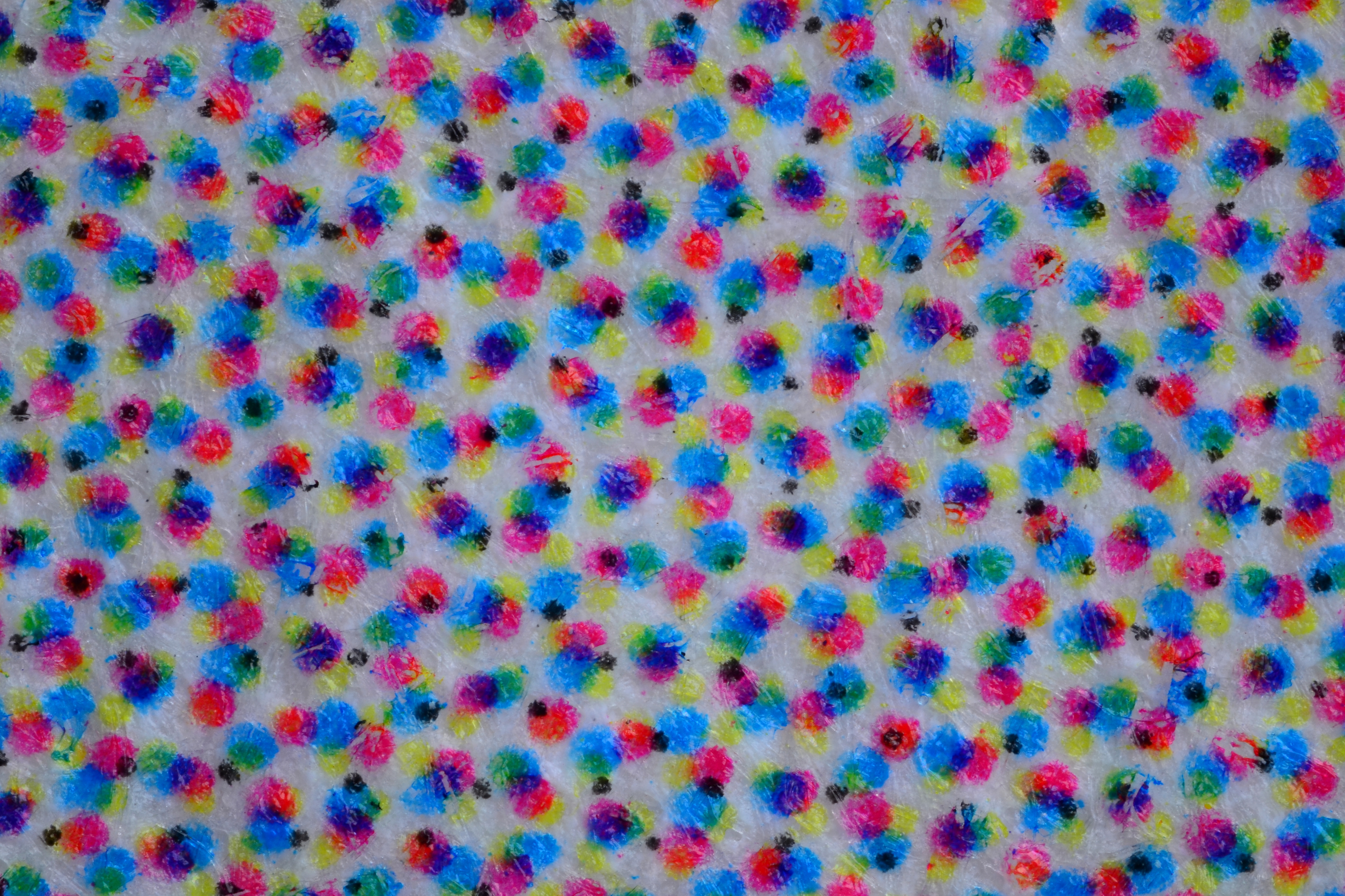

Got my rail oriented properly and aimed it at a business card. The whole frame is printed mid-gray, but as you can see it's really a combination of all printing colors as well as interspersed black dots. With the fibers of the card as well, this seemed to be a nice easy test image.
As before, tube lens setup per Robert's best results with Mity and the ITL-200, except this is the Carmen Haas ITL-200 drop-in. This is the equivalent of 8.6x from a Mity 10x on a 16 Mpxl APS-C DSLR sensor.
The card was not completely flat, and slightly angled relative to the image plane. This is thus a stack of 6 images taken at 10 um intervals, stacked in Zerene with PMax to maximize sharpness and emphasize any CA. There is a mild global lighting gradient across the frame, which is due to a single nondiffused light providing illumination (this was intended as a quick test). It's not vignetting. If I should be shooting with less than 10 um intervals using the Mity, let me know - I'll redo this.
Let me know if you can find any flaws whatsoever. I'm embedding 100% crops, with full resolution link at the bottom of this post.
Center:
Off-center:
Corner:
Full resolution here: https://iili.io/JjAiMv.jpg
Center:
Off-center:
Corner:
