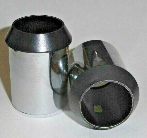

This is not such a big problem. Shockingly, the Orthoplan actually has a 162 mm optical tube length.
It appears that the 30 mm diameter Periplan eyepieces have a 10 mm parfocal length. According to some sources they can be swapped against modern eyepieces with 10 mm parfocal length (DIN) without any problems.
There are Leitz eyepiece adapters for using 23,2 mm diameter Periplan eyepieces ("real" 170 mm optics, 18 mm parfocal length) (centre here: http://www.microscopy-uk.org.uk/mag/img ... 39794b.jpg ) These adapters add exactly 8 mm to the tube length: https://i.ebayimg.com/images/g/qRkAAOSw ... s-l500.jpg to make up for the difference.
So the Orthoplan allegedly has some hidden DIN characteristics. My own Orthoplan is still packed up so I've not been able to confirm that myself.
