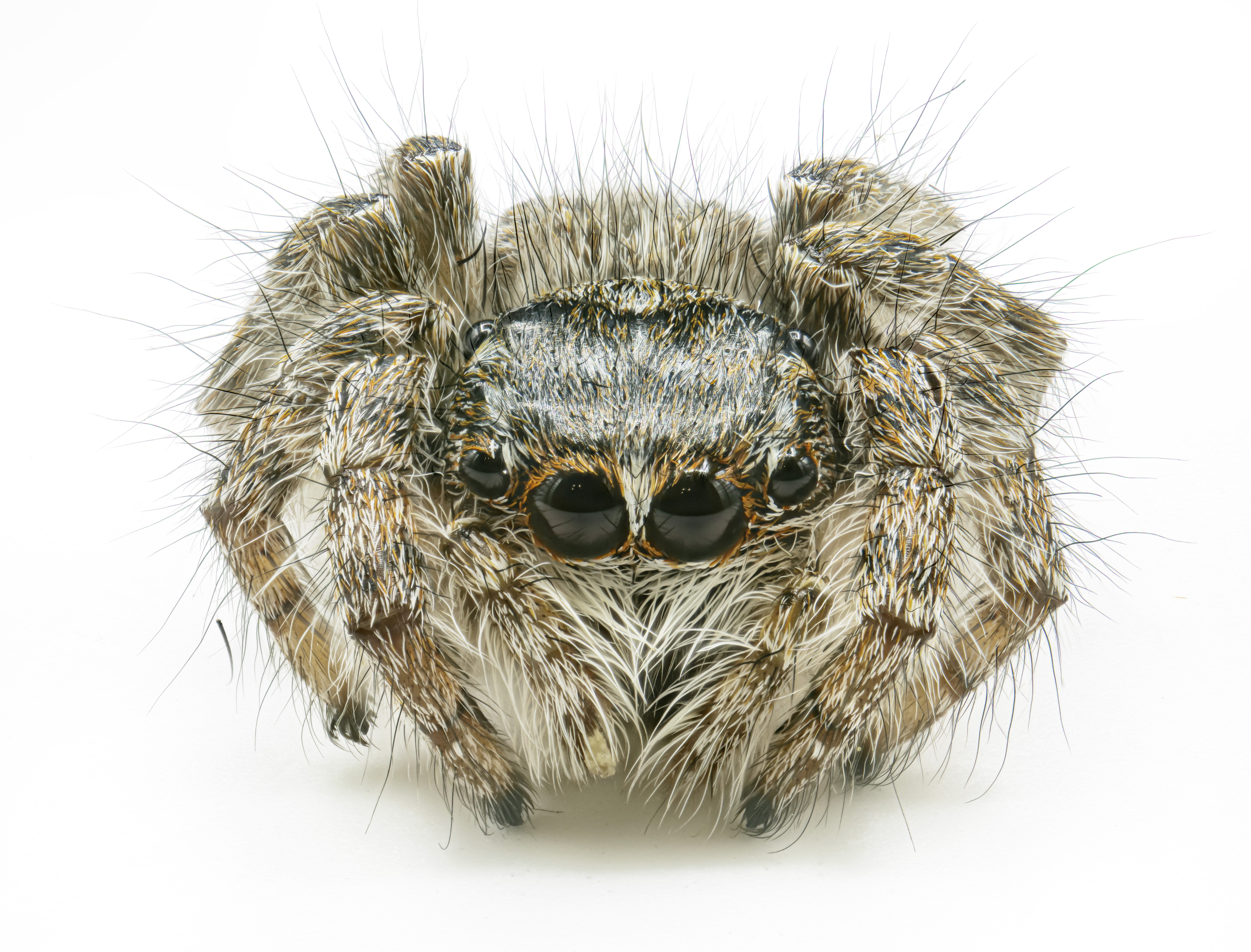

I use my Panasonic G9 with Laowa 25mm... good result ( I think...)
Example https://www.antoniodesantis.it/fs/salti ... _1febb.jpg
Antonio

thanks for the sample, looks good, though light is hard and there is much noise, maybe from oversharpening (?).
Was it shot at 40MP or downscaled from 80MP? I find interesting the 40MP High-res option. I am more than fine with 40MP pixel-shifted images. I think 80MP is an exaggeration, also I don't believe there is actually 80MP worth of resolution.

Yes, 40mpx, better solution :)
This is first focus stacking, i'm looking for best setup for light and postproduction
I'm using Helicon focus trial version now.
