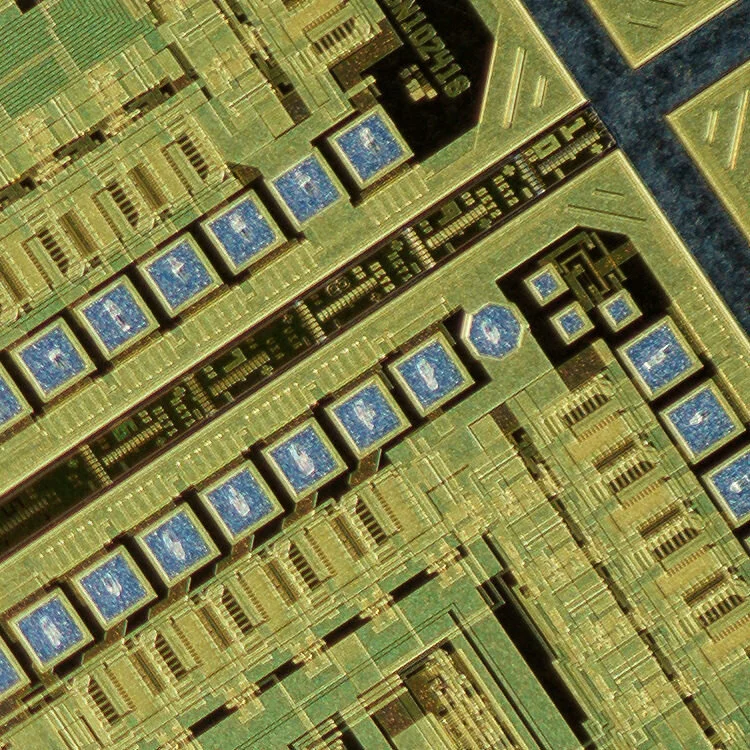

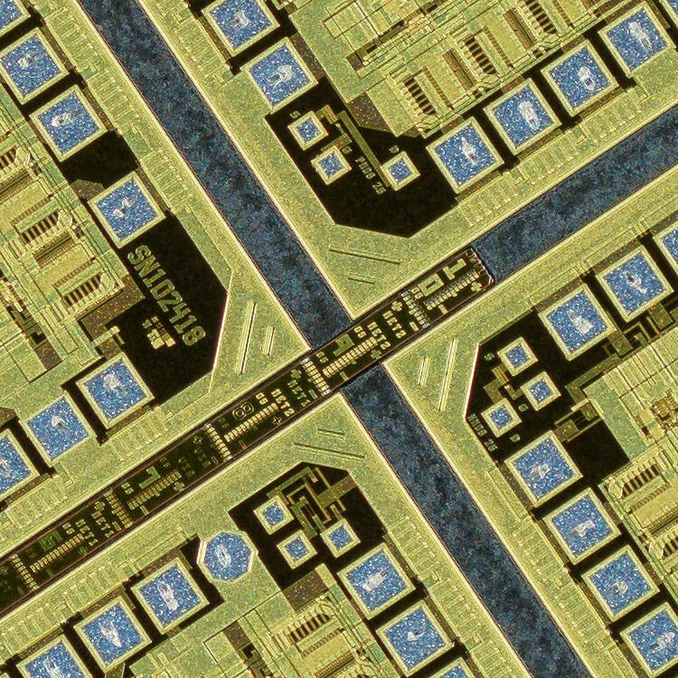

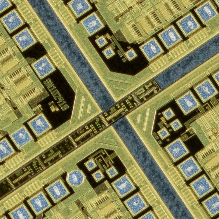

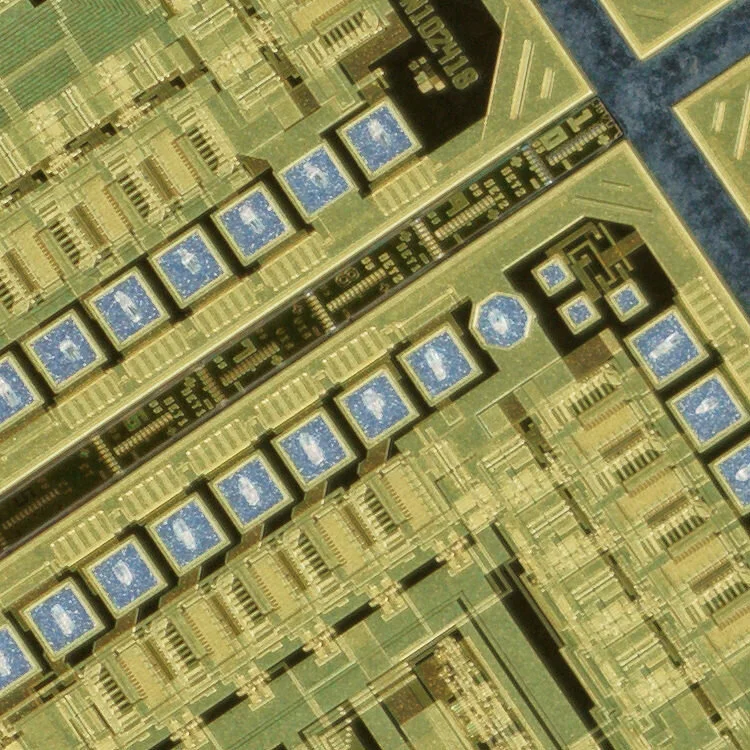

2.6X TEST: SCHNEIDER COMPONON 4/35 VS CANON MP-E 65 MACRO LENS
The Canon MP-E 65 was tested at f/4, the best aperture at this magnification.
Front lens: Schneider Componon 4/35 lens reverse mounted set at f/2.8
Rear lens: Mejiro 5.6/90 lens normally mounted focused at infinity set at f/5.6
Stacked lens nominal test aperture: f/2.8
Stacked lens effective test aperture: f/9.5
Canon MP-E 65mm f/2.8 1-5x macro lens setup
MPE nominal test aperture: f/4
MPE effective aperture for this test: f/17.6
Camera: Sony α6300
Sensor size: APS-C 23.5 × 15.6 mm. 28.21 mm diagonal. 3.92 micron sensor pitch
Vertical stand: Nikon MM-11 with a Nikon focus block
For this test a stack of images was made with 2 micron steps, and was repeated for each aperture. The sharpest frame was then chosen using Photoshop at 100% actual pixel view. Separate images were selected for center, edge, and corner if needed. Each image was processed in PS CC with identical settings with all noise reduction and lens correction turned off, all settings were zeroed out (true zero) and the same settings were used for all of the images.
Canon MP-E center 100% view crop:
CPN 35 center 100% view crop:
Canon MP-E far corner 100% view crop:
CPN 35 far corner 100% view crop:
