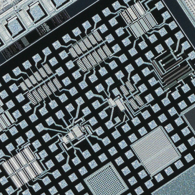

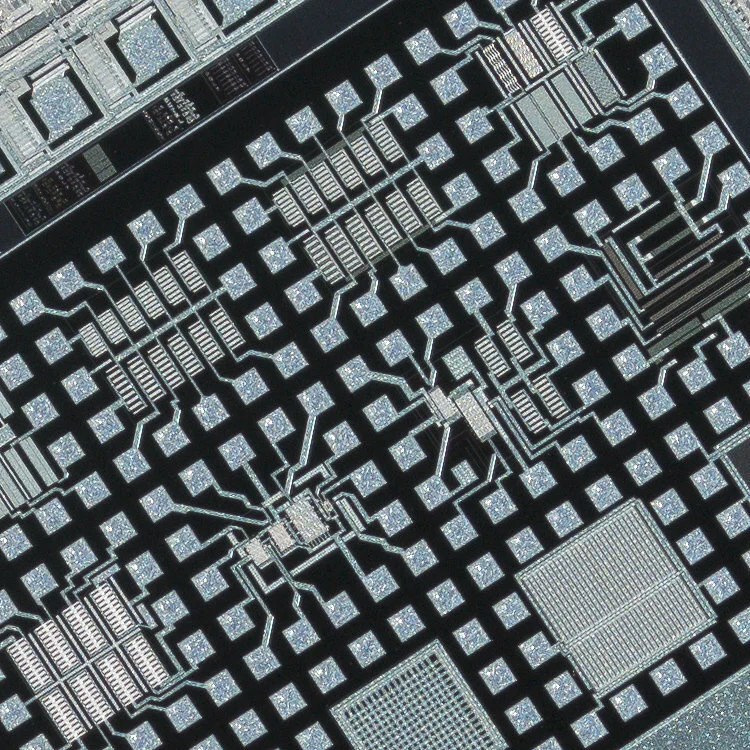

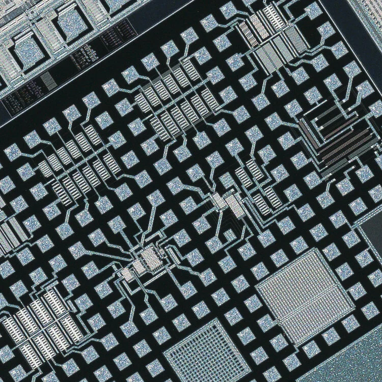

Due to the large amount of images in this test I will post the center crops here from the top lenses in the test. To see the rest of the crops and my notes, follow the link at the top of the post to see the full test on my site.
Canon MP-E 65mm f2.8 1-5x Macro Lens at f/5
Mejiro Entendue OTH100 90mm f/5.6 line scan lens at f/5.6
Nikon Printing-Nikkor 105mm f/2.8A at f/2.8
Nikon Scanner-Nikkor ED 100mm Scanner Lens at f/2.8
Schneider Kreuznach Macro Varon CAS 85mm f/4.5 at f/4.5
Sigma Art 70mm f/2.8 DG Macro Lens at f/4
Tamron AF 90mm f/2.8 SP Di macro lens at f/4
FINAL RESULTS: BEST IMAGE QUALITY AT 1X
1 - Nikon Printing-Nikkor 105mm f/2.8 A
2 - Nikon Scanner-Nikkor ED 100mm Scanner Lens
3 - Sigma Art 70mm f/2.8 DG Macro Lens
4 - Schneider Kreuznach Macro Varon CAS 85mm f/4.5
5 - Mejiro Entendue OTH100 90mm f/5.6 line scan lens
6 - Canon MP-E 65mm f2.8 1-5x Macro Lens
Overall Best performance: Nikon Printing-Nikkor 105mm f/2.8 A

very wobbly setup so there might be improvement.
the FE90/2,8 (@2,8 Center 1:1, on A7 Riv) without and with 16 shot pixelshift on an USAF Target. So group7/3 is around 160 lp/mm if I read correct.
all the best for 2020 :-)
regards
Lothar
Edit this was full frame:
