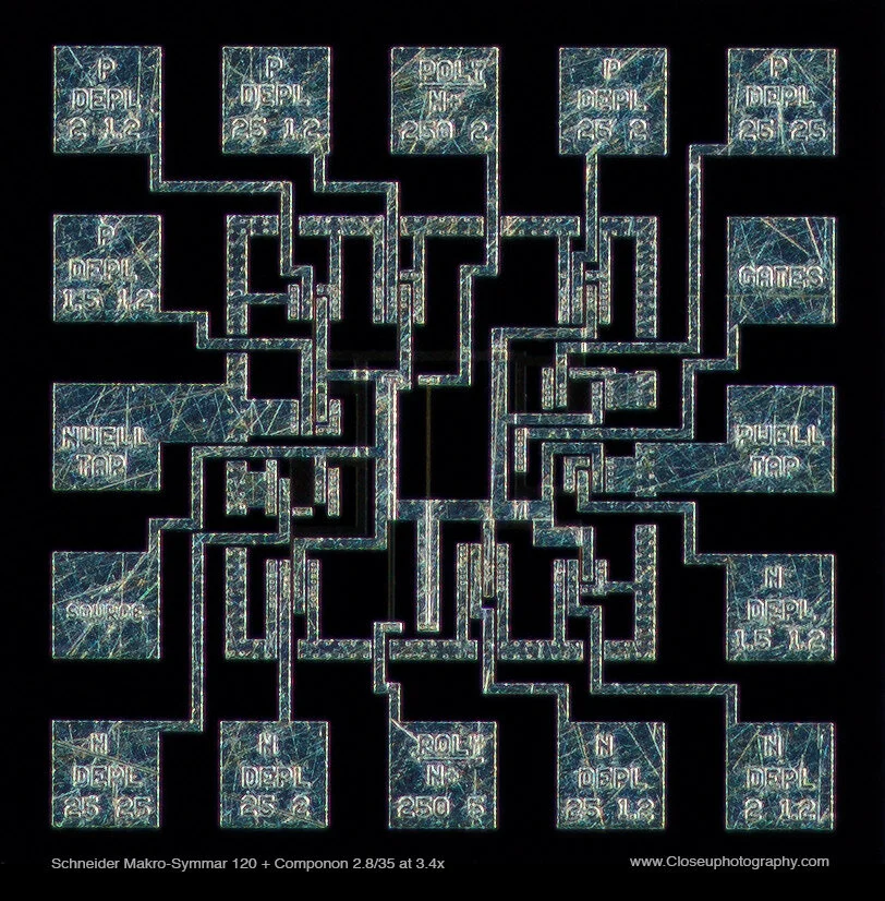

3.4X TEST: GRETAG 120 VS MAKRO-SYMMAR 120
The Componon 35 was mounted in reverse and stopped down to f/3.5 using a paper disk between the two lenses. The Schneider Makro-Symmar is a special apochromatic (APO) 8 element lens, one of my personal favorites, and a fantastic tube lens.
Front lens: Schneider Kreuznach Componon 35mm f/2.8 lens reverse mounted
Rear lens: Gretag 120mm lens normally mounted focused at infinity
Nominal aperture: f3.5
Effective aperture at 3.4x: f/11.9
Rear lens: Schneider Kreuznach Makro-Symmar 120mm lens normally mounted focused at infinity
Camera: Sony A6300
Sensor size: APS-C. 23.5 × 15.6 mm. 28.21 mm diagonal. 3.92 micron sensor pitch
Vertical stand: Nikon MM-11 with a Nikon focus block

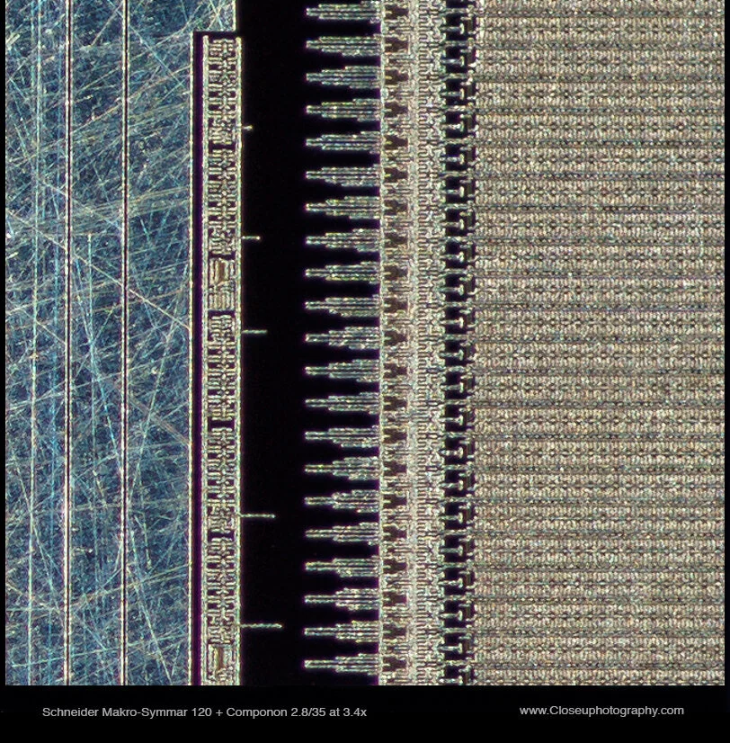

For this test a stack of images was made with 4 micron steps, and was repeated for each aperture. The sharpest frame was then chosen using Photoshop at 100% actual pixel view. Separate images were selected for center, and corner if needed. Each image was processed in PS CC with identical settings with all noise reduction and lens correction turned off, all settings were zeroed out (true zero) and the same settings were used for all of the images. All of the images shown here are single files.
The 100% crop images below are all 1000 pixels across so make sure you click on a thumbnail to open the full size file. You can always save the files and compare them in another the app of your choice.
GRETAG 120 Center
Makro-Symmar Center
GRETAG 120 Corner
Makro-Symmar Corner
Test Results
The results out of the Gretag are amazing. Compared to the Makro-Symmar 120 images, the two are extremely close, these some of the best results I've seen from a tube lens, and I tested more than a dozen, just in October.
The Gretag lens is an excellent tube lens and is highly recommended.

I agree Lou. I chose this corner, the upper right, since it shows the most difference, the lower left is my favorite corner with that disk but they were just about identical. Also the lower right was super close so I skipped it.Lou Jost wrote:Great result! The corner looks better in the Makro-Symmar, but they are close. I had also bought one...
Makes me wonder who made the lens for Gretag, online some of the other Gretag mini-lab lenses are made by Rodenstock supposedly, but who knows with this lens, the CA control is really remarkable.
