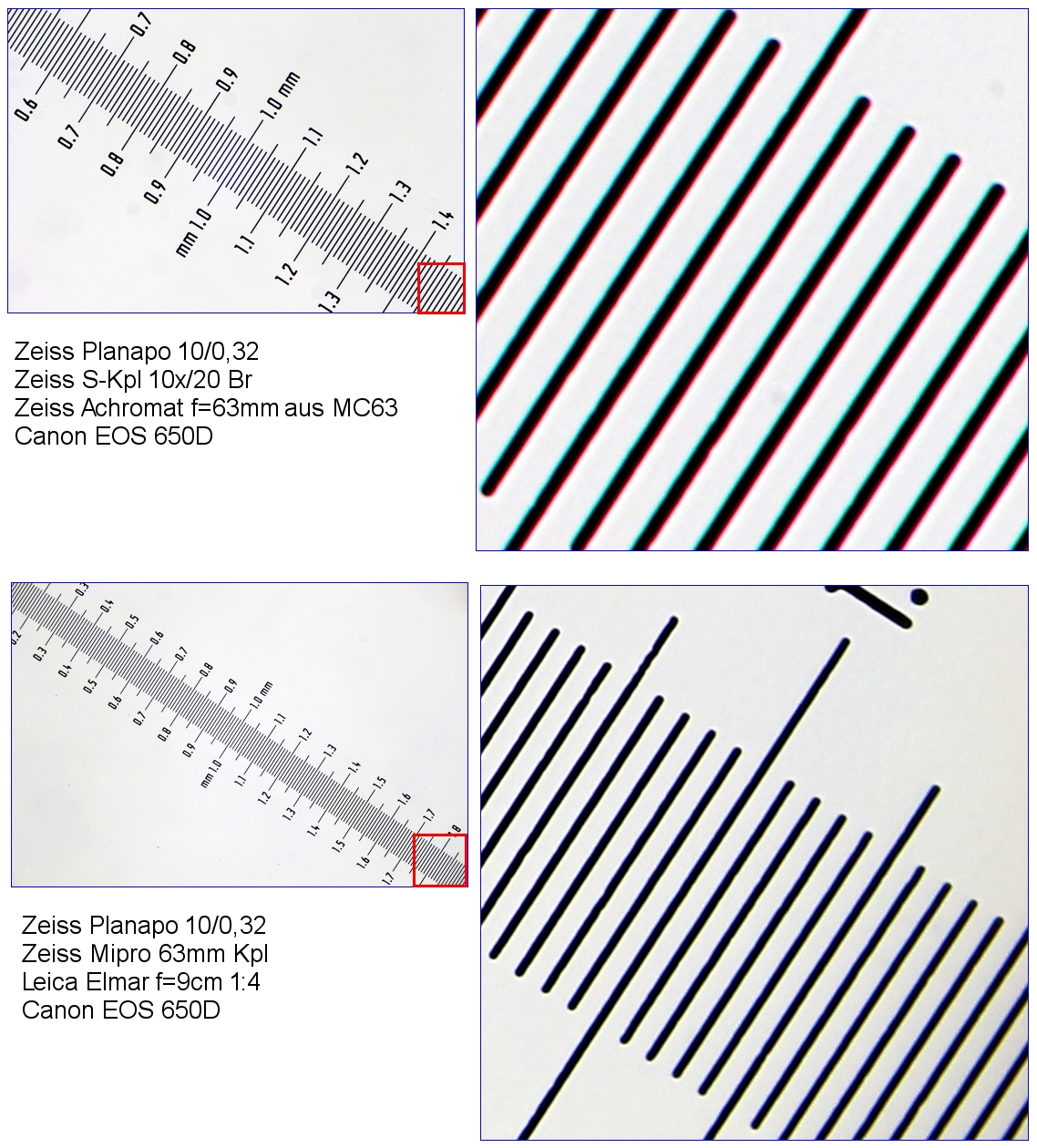

enricosavazzi wrote:This worked well, and I never revisited the other eyepieces.
Hi Enrico,
Maybe you should have another look. The performance, at least of the smaller Mipro 63 and 80 together with a relay optic, is outstanding: http://www.mikroskopie-ph.de/Vergleich-MC63-Elmar.jpg
