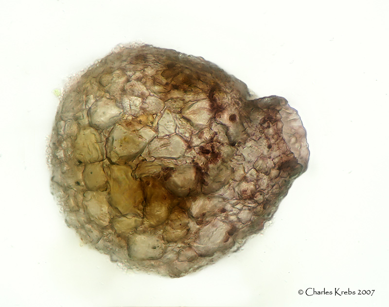

These are always a constant source of amazement to me! Microscopic "pottery" made by an amoeba!
Olympus 40/0.95 S Plan Apo, Canon 350D, bright-field illumination (slightly oblique), 24 stacked images using Helicon Focus

And you always give us the best 3D views of them with your fantastic stacks Charles.
Hi Charles,
very nice! You did a great job in parameterizing the stacking software. But what amoeba? The surface looks like Difflugia and the shape like Lesquereusia.
So long, Wolfgang
PostPosted: Sun Jul 15, 2007 9:35 am    Post subject: Reply with quote
Yes, I thought that very same thing! I have seen such amazing variations of these tests. It really is a shame they are so difficult to photograph well. Stacking is a big help, but my biggest problem has been the "depth" required by the subject and my inability to get a nice sharp image (of the deeper sections) due to spherical aberration. And this is even with a 40X that has a correction collar. I'm beginning to think that I should try to collect some specimens and try it "dry" with a 40X objective designed for use without a coverslip.

Charles Krebs wrote:
... I'm beginning to think that I should try to collect some specimens and try it "dry" with a 40X objective designed for use without a coverslip.
Looking at your picture I have no idea what could be done better... Smile
Some words to objectives designed for use without a coverslip. Are there any for brightfield use? In former times I used a 40/0.95 objective with correction collar. For me this was not satisfying. Since the time I'm using a 40/1.00 oil I'm happy.
Have you ever tested a 40x oil?
Cheers, Wolfgang

Gorgeous image, with respect to biological documentation as well as artistic value, Charles. It displays on my monitor so crisply and three-dimensionally as if I just could grab it.
Truly, never have I seen a better picture of Testacean "pottery" than this before. Thanks for showing.
I have a 40X Zeiss Plan Apo oil. Unfortunately it has some of the dreaded "delamination" so common in those objectives. It still provides a very good image, and does make things simpler as far as not needing to fiddle around with an adjustment collar. But I am not convinced that it really is better when a subject is rather "deep" in the water under the coverglass.
Wolfgang...
OK, good to know that one can handle the 40/0,95. I gave it up, years ago, but you show that one can handle.
But I think that the appr. homogenous immersion could make it possible to image subjects in deep water a little better than "dry" objectives (I don't know the correct expression). Unfortunately I'm not able to test...
